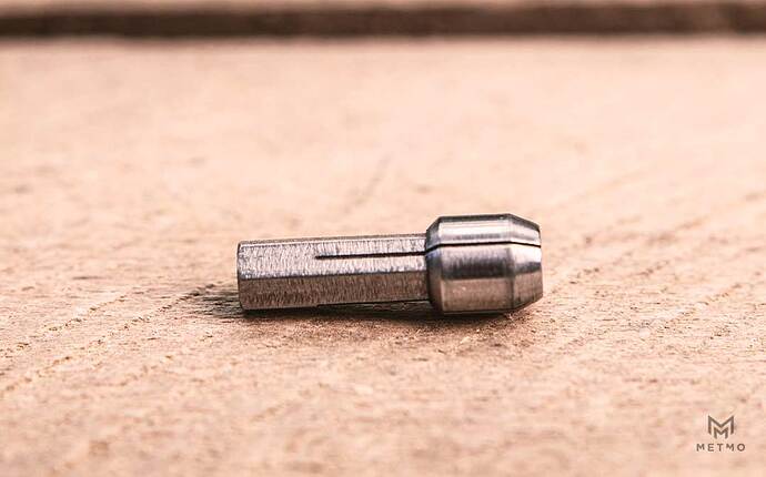

Collet
Inside the chuck sits our humble collet, a custom designed hexagon shank gives it a firm engagement. Unlike a normal collet that would only spin in one direction this shape means that it can withstand a twisting motion of a screwdriver and the uneven pressure in different directions.
Made of a special type of stainless spring steel, once heat treated this metal goes from very rigid to a much more spring like material, we are using a very thick section of it here so it’s not like a conventional spring that will be all bouncy, but instead will last a lifetime of repeated flexes and powerful clamping :flexed_biceps:.
The fine thread inside the Chuck allows a large mechanical advantage to be applied to the end of the collet and the shallow pitch of the thread locks everything in place with no slack at all.

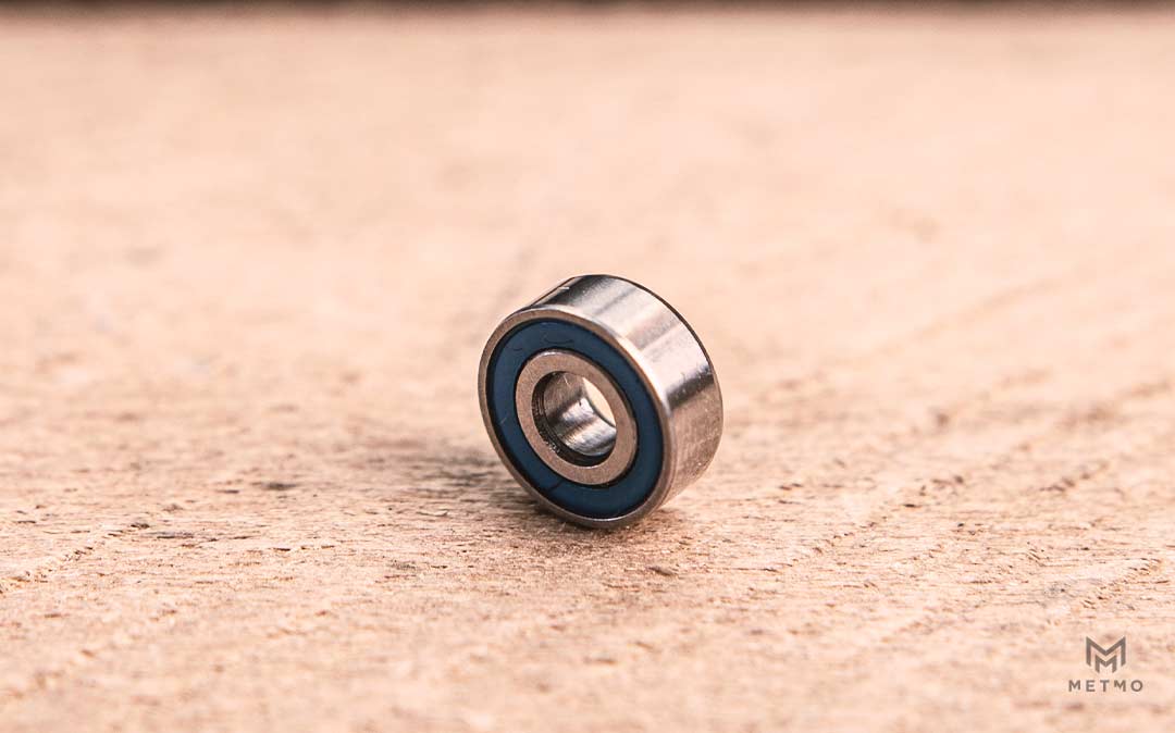

Bearing
This is a stainless steel single row deep groove ball bearing, with seals on both sides, and according to the manufacturer “they have low friction and are optimised for low noise and low vibration, which enables extremely high rotational speeds.“ Sounds like total overkill for a cap bearing on a screwdriver, so it was perfect for us!
In real terms though, because the area where it goes is so small even the best of bearings start to struggle with being pushed, pulled and chewed on by alligators. So, we had to go for something that would withstand that. We put the biggest bearings we could fit in here and made sure it was sealed so you wouldn’t have to worry about maintenance on them.
Watch out though, they are only rated to 130,000 rpm so don’t go trying to attach them to your turbine engines.

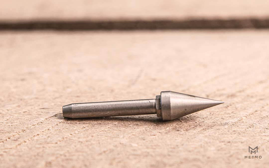

Scribe Adaptor
Scribe time. Some scribes are made of tungsten carbide but we have real trouble machining that, so these are hardened tool steel. Tool steel for reference is what you use to make cutting tools out of and what we use in our lathe to cut metal and make things like Multi Drivers. So, we figured it would be more than strong enough for marking up anything with daily use.
With a lot of use on metals like stainless steel and hardened metal they do wear down, but can easily be re-sharpened with a whetstone, or on a grinding wheel.
The holding end of the tip is the hidden part of the iceberg. With both a hexagon to engage and lock in and then the round spindle to add flexing stability, the combination of the two of these when put in the collet, turns the tip into a rigid part of the handle, so there is zero movement. Something we were aiming for to make this ultra precise to use.
And sure, you can break a toughened window with it, but it’s a bit like using a Saturn 5 to open a bottle.
