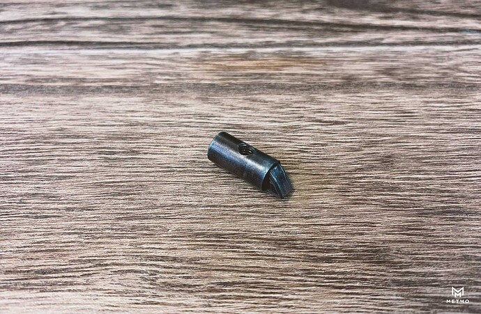

Barrel Pin
We knew from the outset this was likely to be a weak point, even though on the originals this was much smaller, we increased the contact area by 4x compared to the original patent. We also decided to up this to a tool steel that is machined then through hardened. Once hardened it can no longer be easily machined making it incredibly hard wearing. This is also unique in that it’s very high in chromium, so it is still corrosion resistant even after hardening.
We’ve left this part with its natural darkened or deep purple treated surface, unlike the chuck that is treated, then we sand back the surface just enough to bring through the natural colour of the steel on the outer surface.

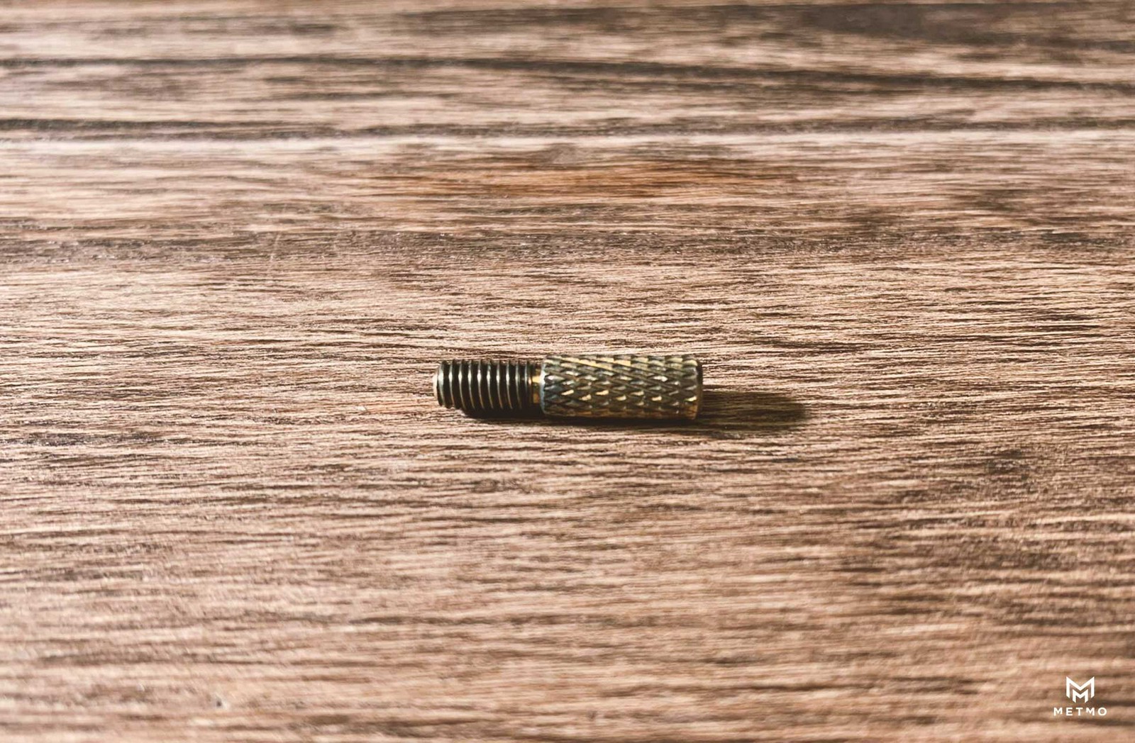

Pin Handle
No Ratchet would be complete without a forward and reverse capability and this component makes this possible. Since its only function is to move the barrel pin into a new position, we opted for a knurled brass over the original steel ball ended pin. The extra thickness in our design allows for the knurling and makes it much easier to handle the pin. We also added a screw thread on this part so it could be easily replaced or maintained if needed in the future.

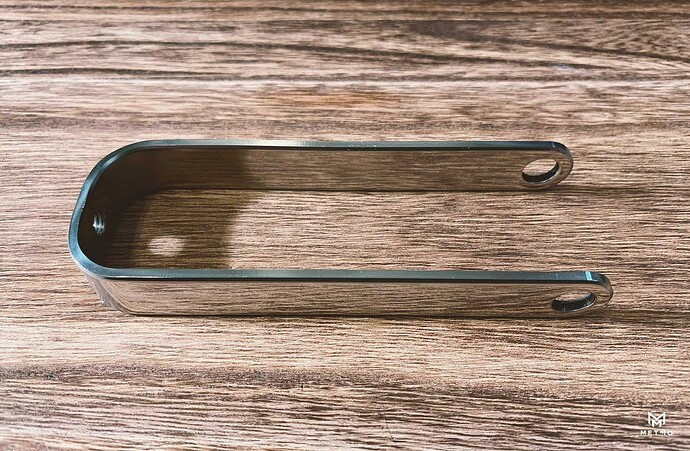

Bent Arm
The stainless arm and the part that is going to get the heaviest handling of all! We looked at a lot of the originals and observed there was not much deformation on them, considering their age and use. We knew this component would need to over perform, so switched the original mild steel in the patents for a thicker hardened stainless variety, this is machined from a solid plate before being bent on a CNC folding machine, heat treated and then hand finished.
The looped handle in this design was taken from the original and is actually very clever, as although you are pulling or pushing on the arm, it translates that and both pulls and pushes at the same time, so is always spreading the load evenly around the axis of the screws, so you are not wasting any motive effort.

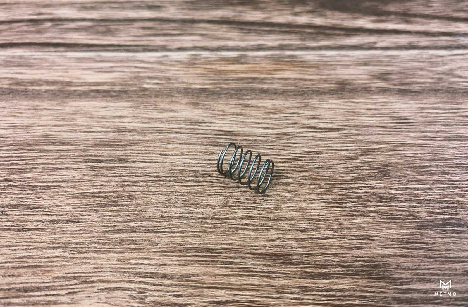

Spring
A classic spring, these are just fun. This is essential to the whole driver working as it allows the ratchet, to well… ratchet! And applies constant force to the barrel pin, allowing it to reciprocate when the chuck rotates. We first tested our 3D prints with a cut down spring from a MetMo pen (as we had a few of these laying around) and as luck would have it, the tension was about right! Obviously we use a spring that fits snugly into the barrel now, but that tension is still about the same.

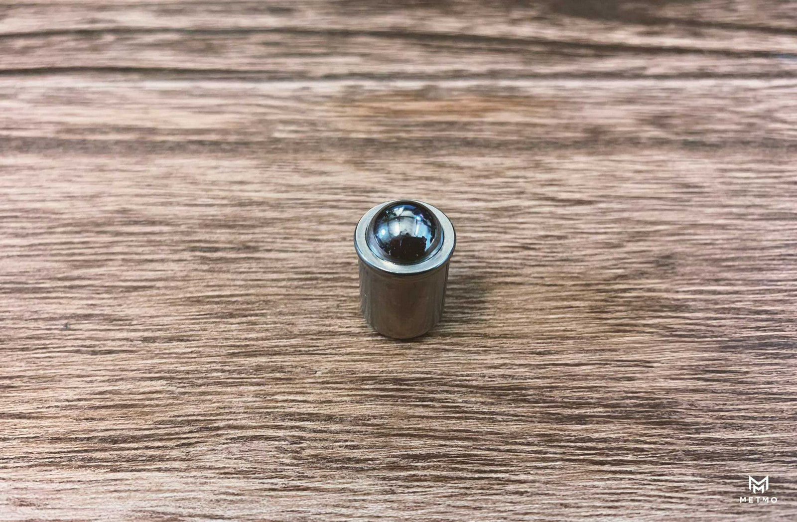

Steel Spring Plunger
True to the original we have kept this feature but have upgraded it to a stainless so it doesn’t rust. We found these spring plungers to offer a much more satisfying click of the handle as it locks into place, as well as being much more secure and reliable over many 10’s of thousands of repeat operations

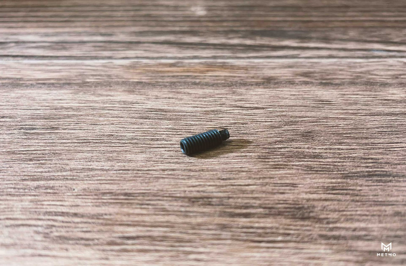

Grub Screw
What can I say about the humble grub, it’s a screw with a custom pin end that aligns perfectly with the chuck shaft and really ties the handle to the rest of the driver, but importantly still allows the handle to spin freely. Simple but effective, and based on a technique that has been used for hundreds of years.
