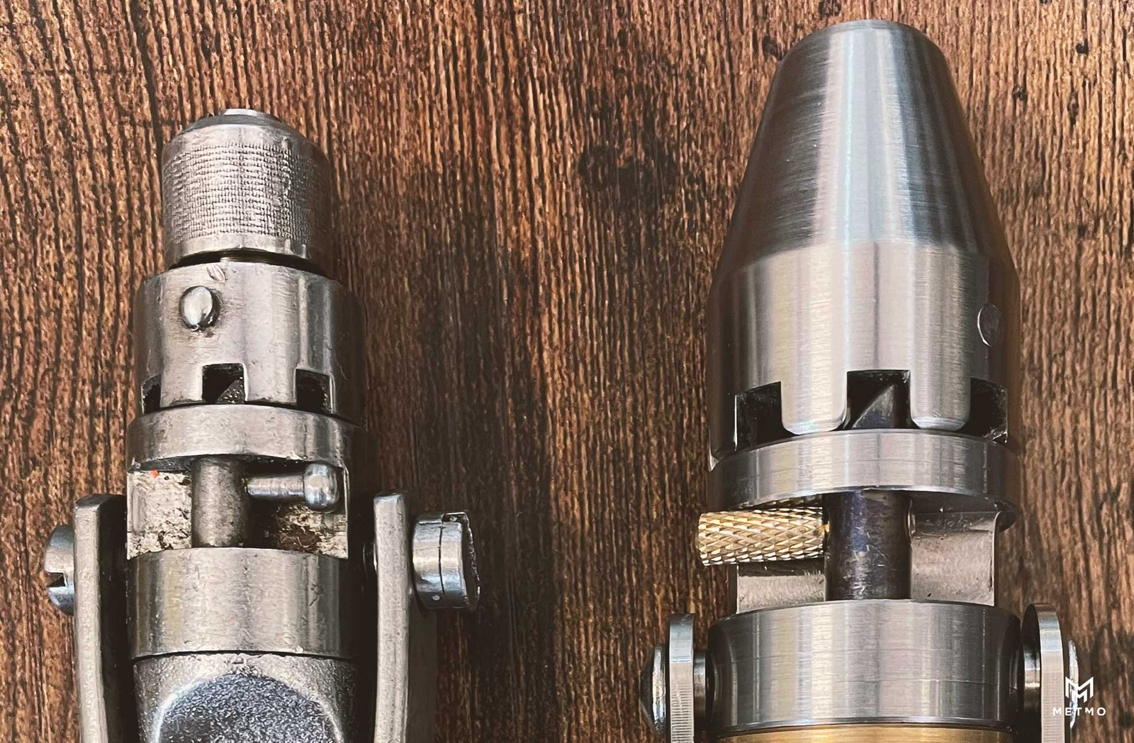

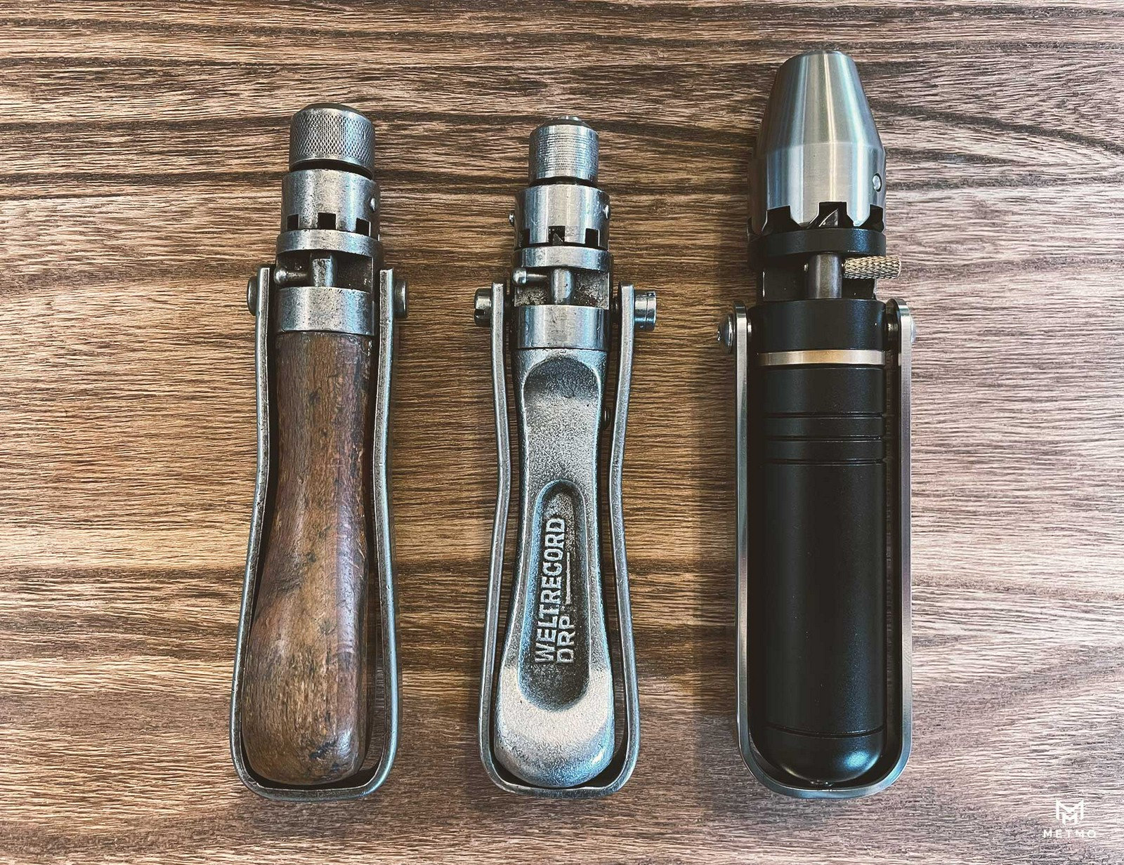

We had 2 versions of the design to take inspiration from; a very early 1900’s model and a newer 1970’s version.
Taking a look at the original, you can see the 70’s design is slightly slimmer than our version, which was most likely a cost issue back when the tool was being produced. We preferred the look and feel of the earlier model, so we kept more to those sizes.
The adjuster pin to change from forward/reverse/locked is now a knurled brass component which is much easier to interact with than the original pin, especially on cold days in the shop when you’re in two pairs of gloves and full arctic survival gear!
The chuck and reciprocating pin have now been hardened to increase wear resistance and the much larger chuck has a broached hex drive with a neodymium magnet mounted internally to hold all standard bits. This was a major step forward from the old design which used specialised bits and a collet system which has long since seized on our unit.
The free spinning handle has been helped along by the introduction of a brass bush and the size of the earlier model allows you to get much more weight behind it to prevent slipping and damaging a stubborn screw.

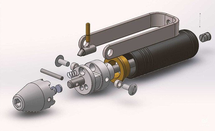

Then the real magic begins in converting everything into 3D. We use a program called Solidworks, that is engineering specific and is pretty good at translating everything over to CNC.
Modelling in 3D is great as it lets you test so many things before ever cutting anything. During this stage we developed how the handle would interlock, the size the ratchet would need to be, the spring size for the pin… basically everything!

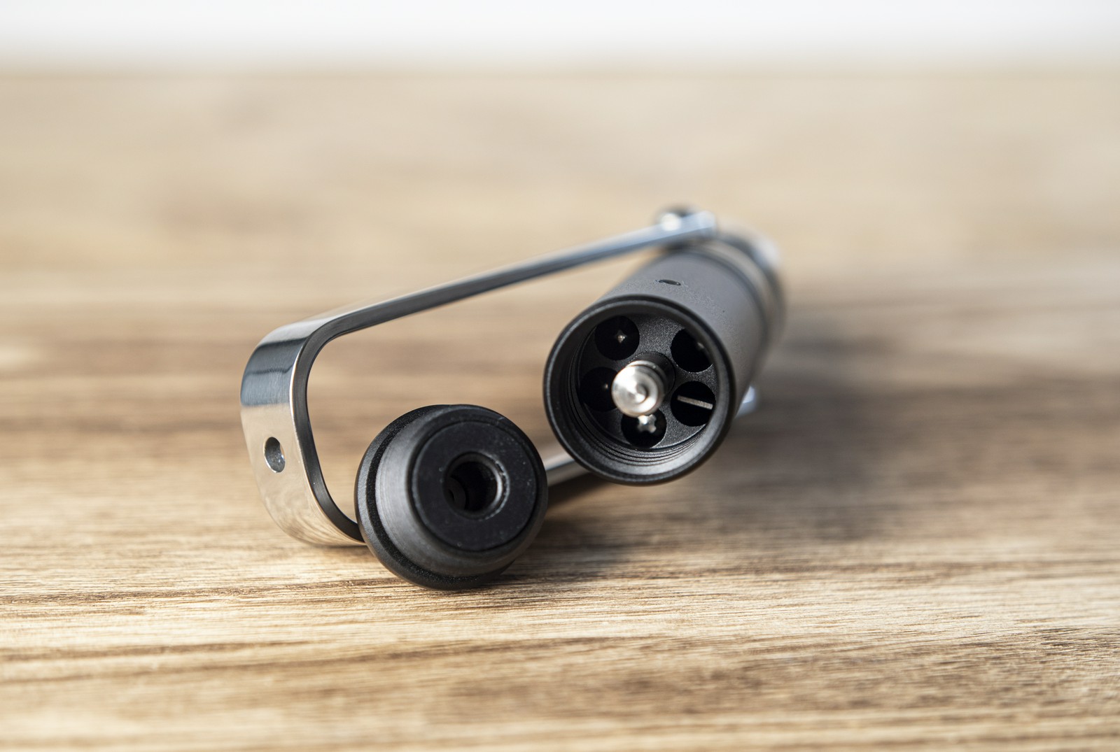

This is where we ran through a number of iterations, making prototypes on our 3D printer and testing how it worked and felt, then modifying the computer data until we had something near perfect
These later 3D prints did actually work too! They started to show stress marks after extensive use and they would not handle anything heavy duty, but could dismantle plugs and wall sockets pretty well! And gave us an indication that we could move on to more robust prototyping.
