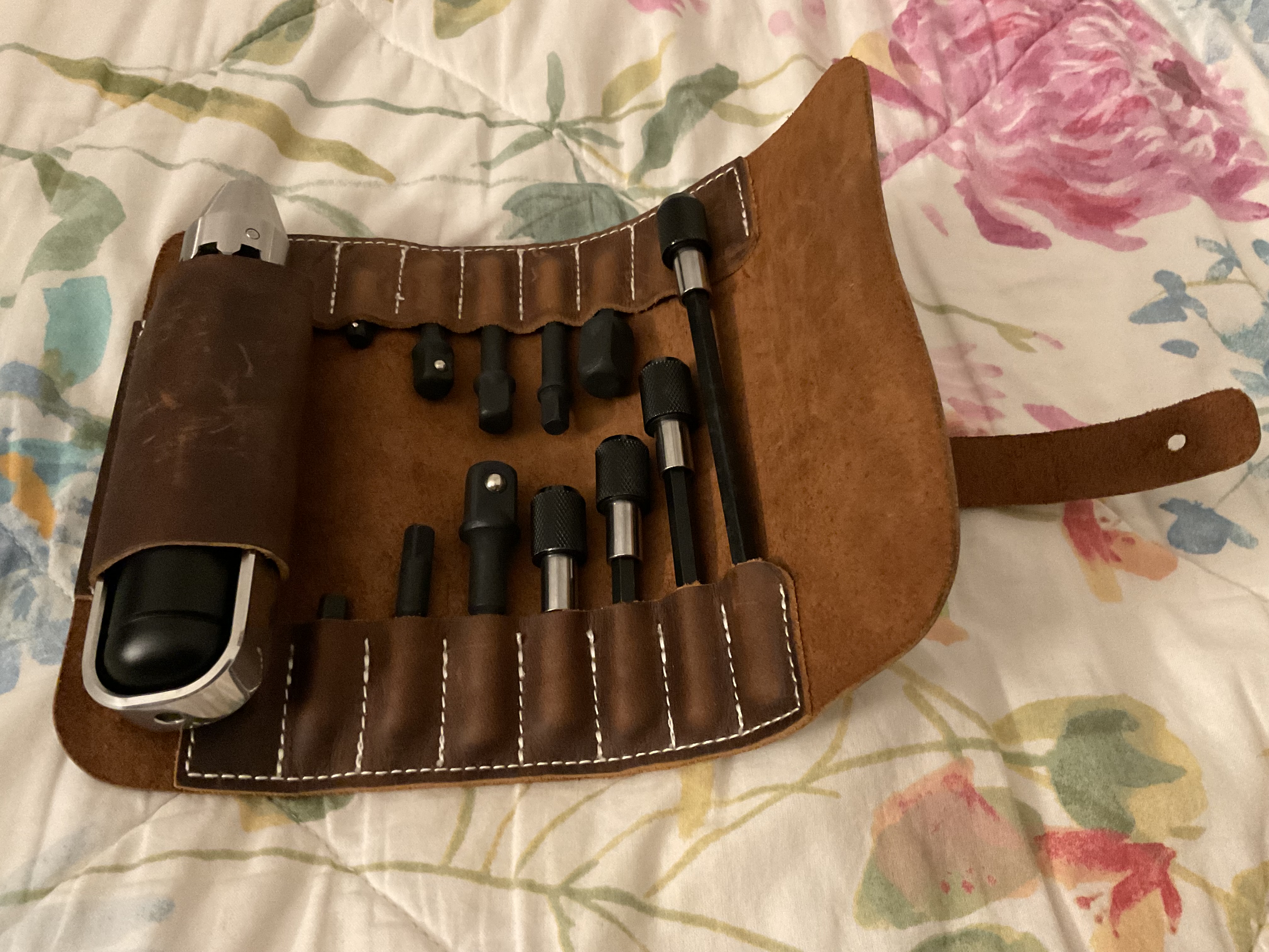

The Driver is an awesome tool that feels so great to just hold and fidget with the mechanism! I bought it with the Leather Expansion Kit! The leather feels so awesome as well!
A question: The driver handle feels too tight and cannot seem to smoothly rotate around the body easily. I loosen the side screws that hold the handle to the body and its a bit better; but then the screws continue to loosen up with rotation of the handle. Is there a sweet spot here?

Glad to hear your Driver arrived for you! That is a lovely looking Driver!
If you’re finding the body isn’t rotating as freely as it should, I’d recommend using the supplied Allen key to loosen the grub screw in the body of the Driver ever so slightly and this will make things smoother. Just a half turn should do it. I wouldn’t recommend loosening the handle screws as you don’t want them to back out and get lost!
