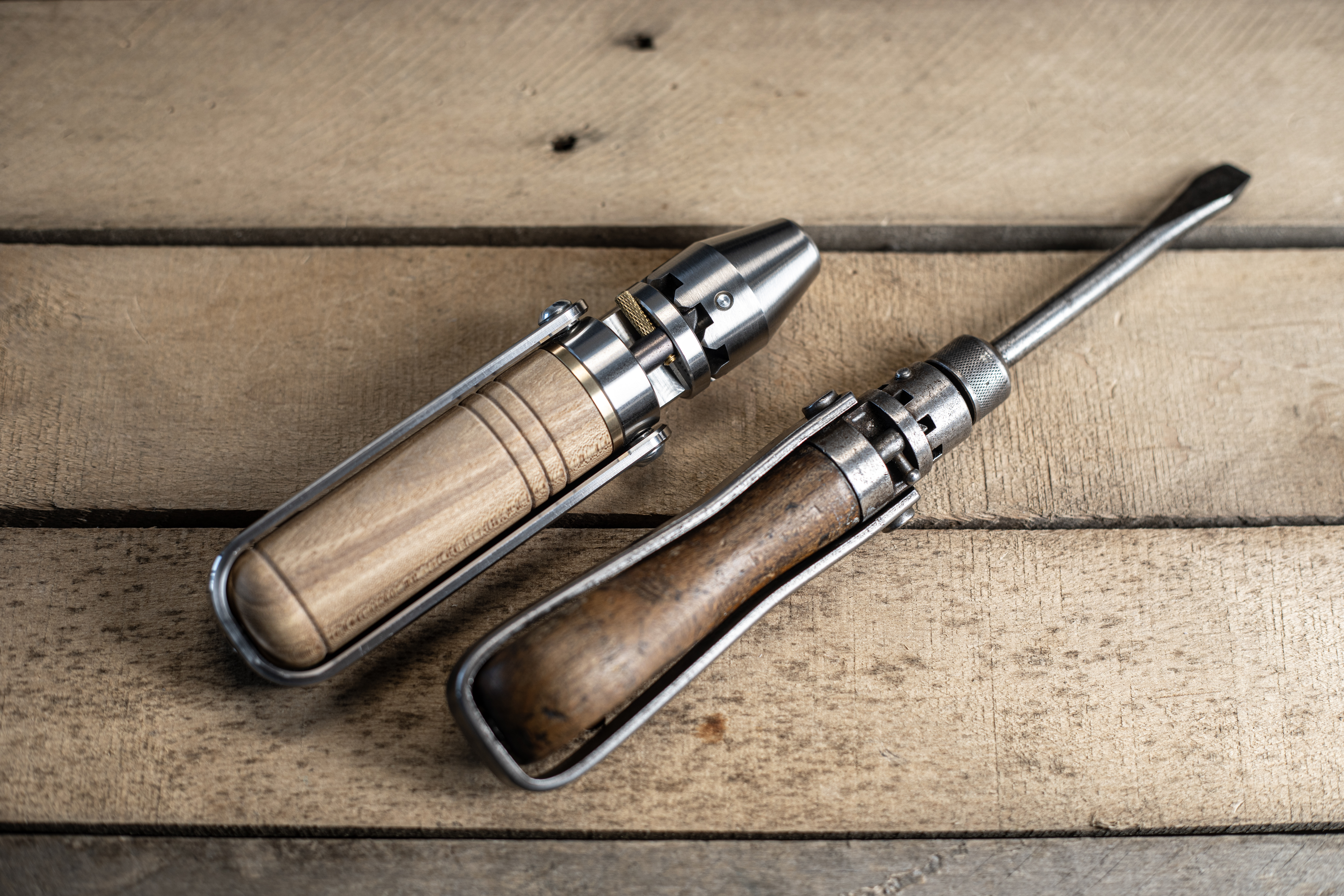

Mirroring The Original

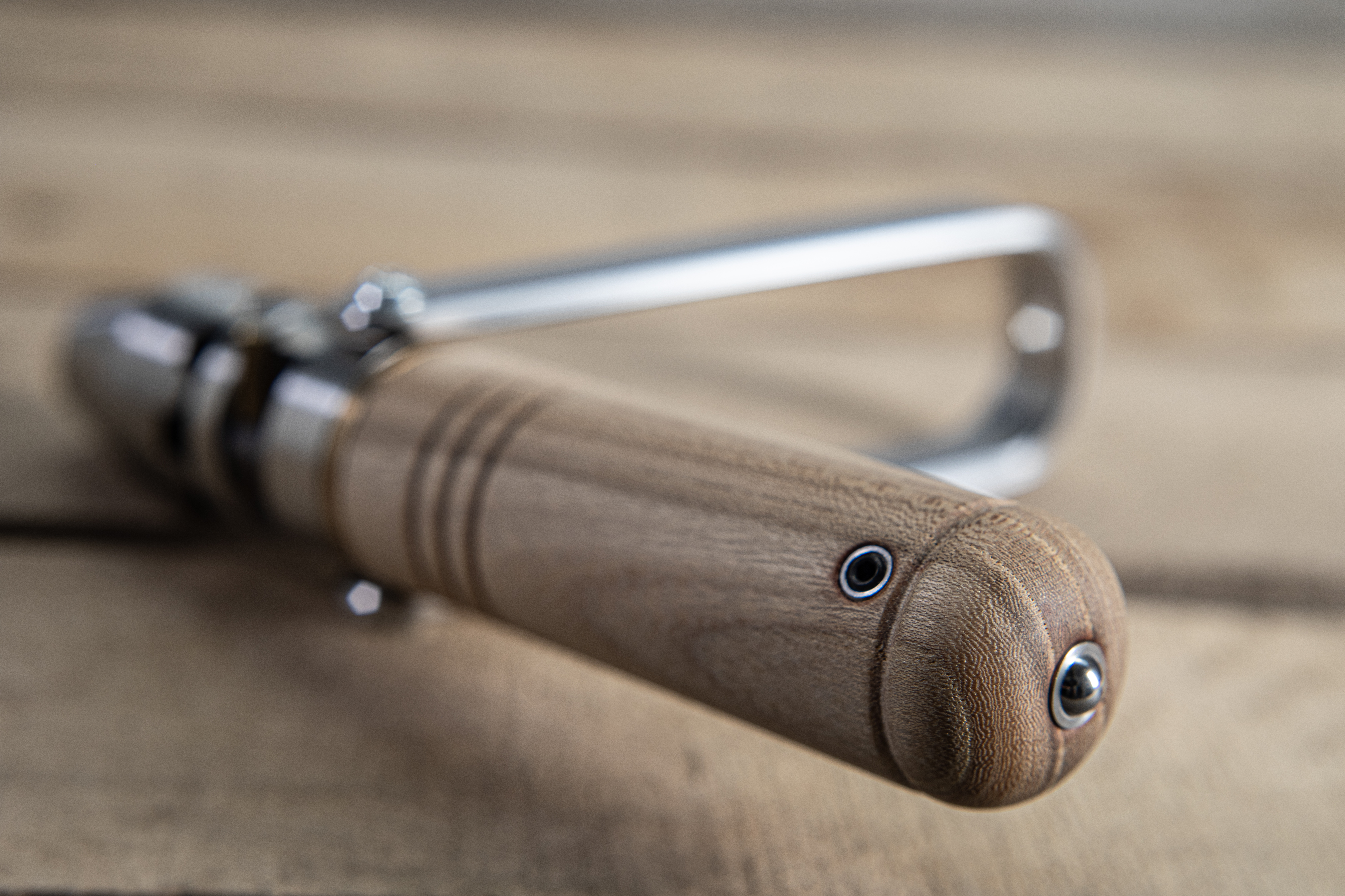

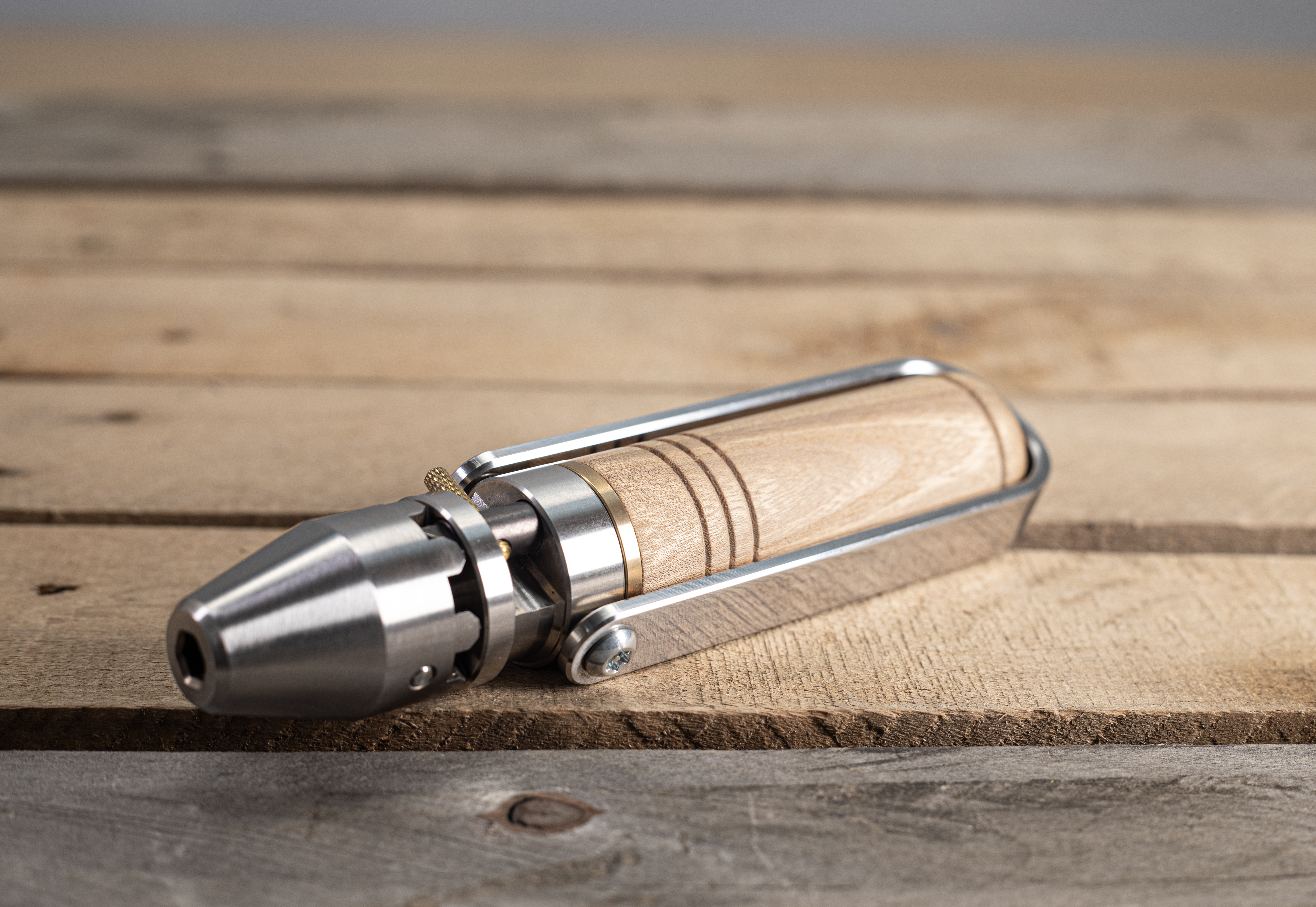

Like the original Weltrecord driver by Conrad Baumann, the mechanical parts have the steel look using the same hardened martensitic stainless steel parts we use for our Steel Drivers, making this a serious work horse that will drive whatever you need, whenever you need it.
Stainless Steel Fixings
The ultimate blend of wood and metal. Like all fine medieval ballistas, we’ve paired the wood with press-fit stainless-steel ball detents and inserts for the grub screws, so this handle can be taken off for maintenance the same way you can with our metal versions.
