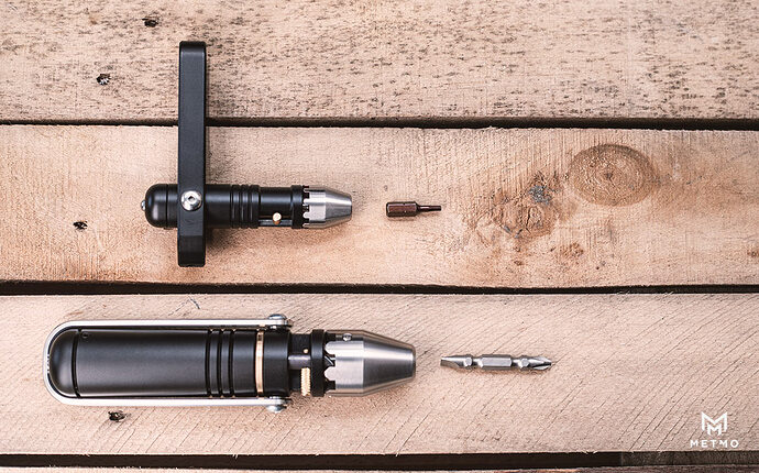

Let’s start with the biggest fundamental difference between the big Driver and Pocket Driver - the Pocket Driver handle is fixed and does not spin like it’s big brother. This catches a lot of people out, but the original driver, unless used with the arm closed, is a 2 handed tool. The Pocket Driver is a single-handed tool, so ideal for smaller jobs where you need an extra hand to support what you’re working on.
With the original, the handle spins freely and you can lean on the driver with all of your weight so it can drive wood screws, masonry screws and decking bolts with ease. The handle on Pocket Driver being fixed makes it easier to handle and put in things like hex screws or assemble flat pack furniture, where you really need 3 hands!

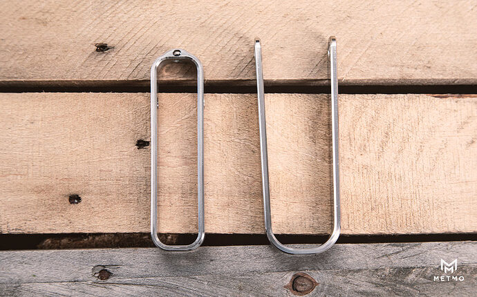

The arm is the big visual difference and is also made very differently to the original. The original handle is laser cut out of sheet stainless steel, then bent to shape using CNC machinery. The Pocket Driver arms are milled out of solid billets of plate metal.
The pivot point is much higher on the Pocket Driver so it creates a T-Drive handle when popped out, so again is perfect for single handed use and is much faster to use with smaller screws. The original Driver works best at 90 degrees when the arm is lowered, whereas Pocket Driver has four different arm positions to help you adapt to different situations.
We really liked the inline grip that was possible with the original Driver when it’s arm was in the closed position, which allows for quick use with plenty of torque as you can get a lot of purchase on the sides of the arm as you turn it. As we took the Driver into the micro realm, we really wanted to keep this feature, but noticed the smaller form factor didn’t let you get a great deal of power through it. With this in mind we experimented with many different arms styles to find the perfect form and finally settled on a full wrap around design that allowed you to pop the handle a fraction to create our offline mode, still allowing access to tight spaces, but with a bunch more torque.

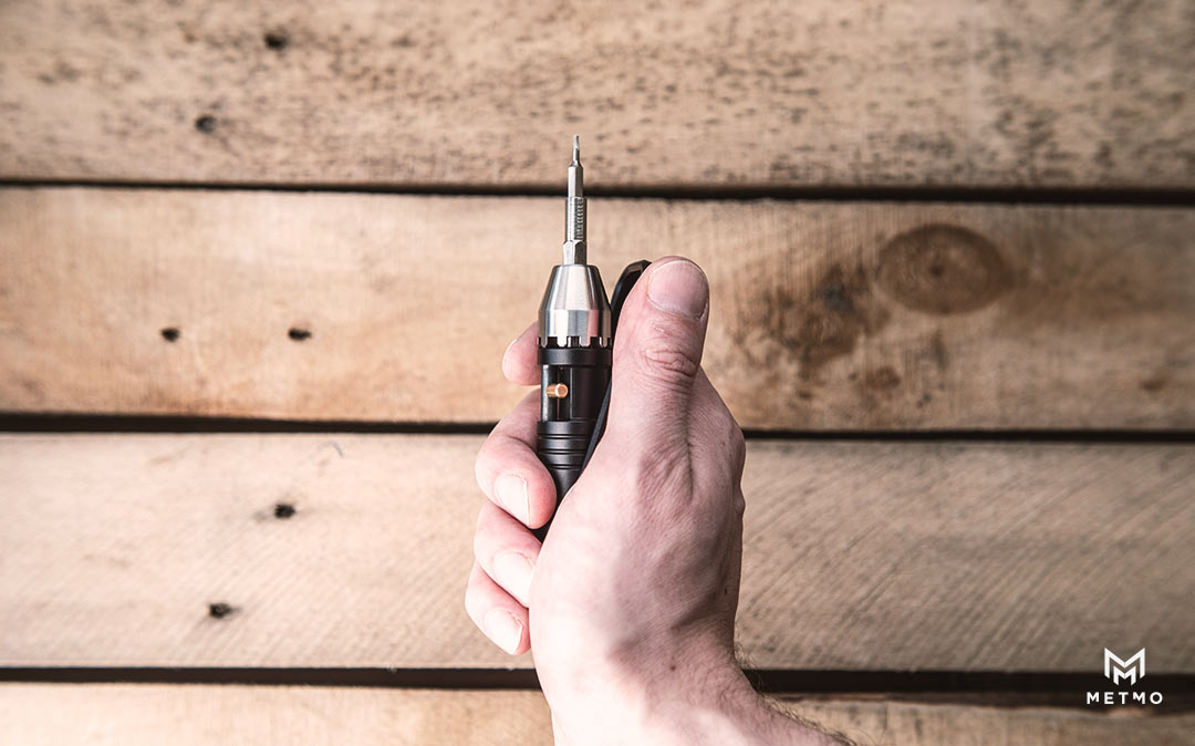

The next major development was with the Pistol Grip mode and is what really stands out when you’re using Pocket Driver as it perfectly fits in the palm of your hand… and also kinda reminds me of the cricket from MIB.
Here’s a quick overview of the grip modes from the campaign page:
- Inline - Quick access, low effort assemblies with maximum control
- Offline - Great for hard to reach places where extra torque is required
- T-Grip - Maximum power for tough assemblies
- Pistol Grip - Ergonomic grip that can deliver a lot of power with plenty of control

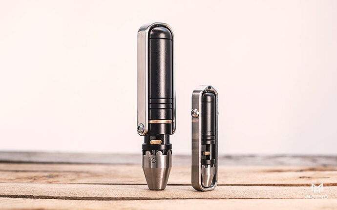

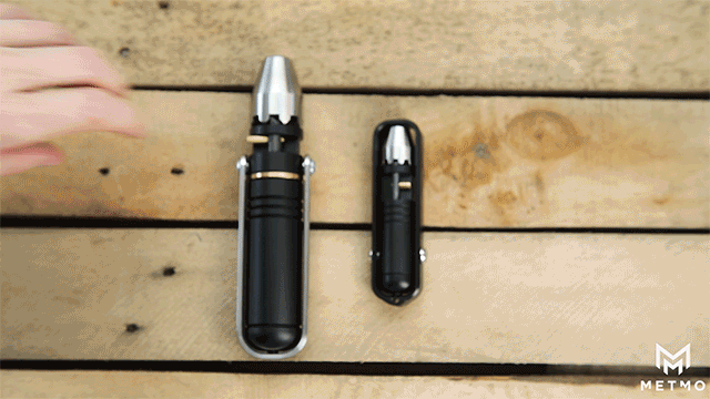

Pocket Driver is much smaller, at about a third of the physical size but more importantly a lot lighter. With the original drivers we couldn’t make them in full stainless steel as they would have weighed far too much to be useful, but on Pocket Driver we’ve been able to have a full stainless version. It still has a good solid weight to it, but won’t pull your trousers down!

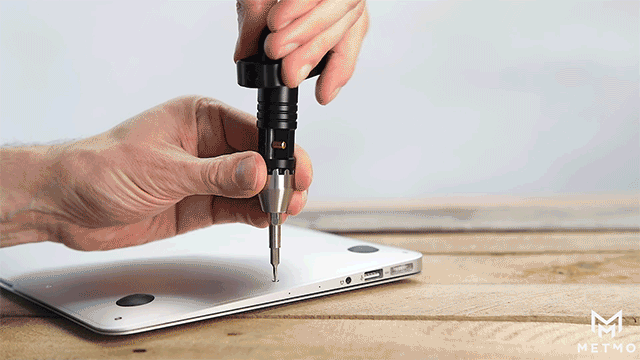

Pocket Driver has a smaller arm and with one hand logically you will apply less torque through it, but that’s not a bad thing! Tailored for smaller screws, it gives much more control and there is less chance to damage tiny screws heads. You wouldn’t use a sledgehammer to put in a panel pin after all, unless you’re Thor maybe…
Precision
Power
The big Driver was more compact than a battery drill, but still too big go get inside a modern engine housing. Pocket Driver can really get inside of something and dismantle it from the inside out when you are up to your elbows in a job and can only just about reach with one hand, that’s where Pocket Driver comes into its own.
