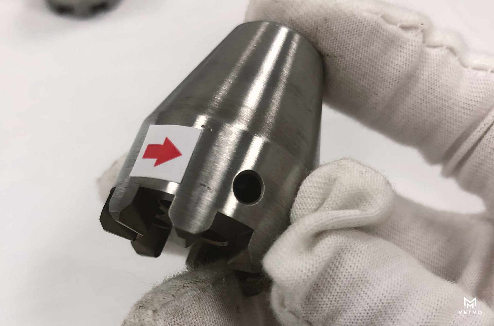

The chucks
As you can see there are some cosmetic dents, after we investigated this was annoyingly caused not by the machine shop, but when they were sent out to be heat treated they were not packaged adequately, so they dented each other in transit… This is an ongoing battle we have with trying to get engineering businesses to make products where the visual matters! This didn’t affect all of the parts but around 30% are already being remade/polished up. At least we can use the rest of the parts straight away!

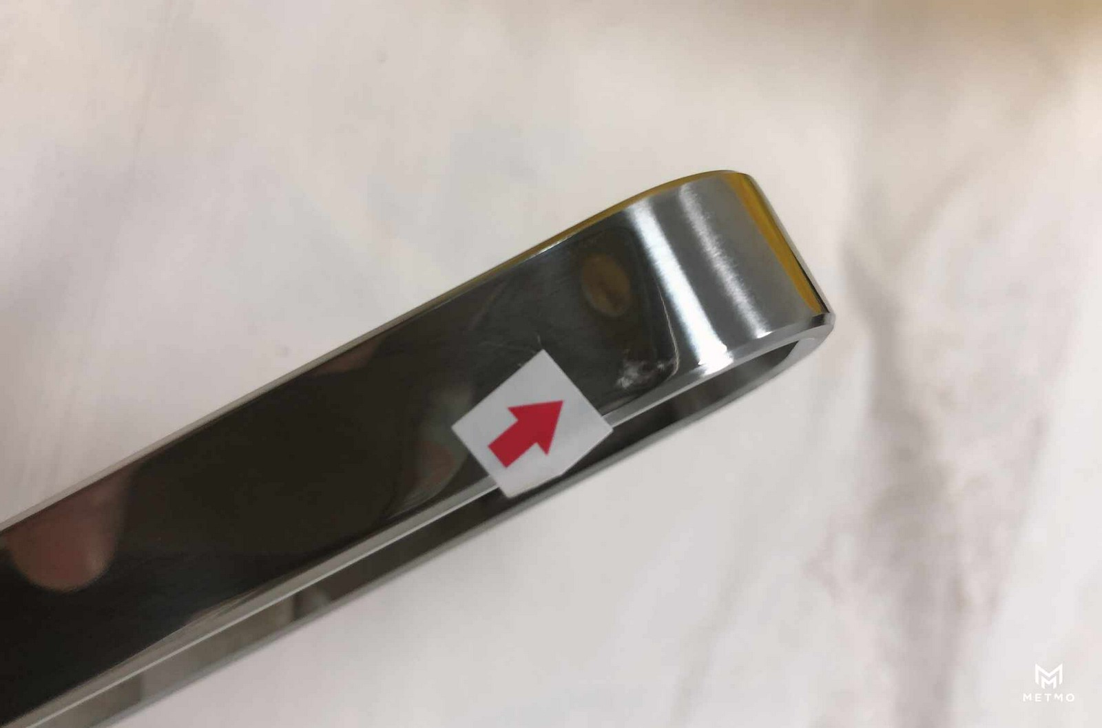

Bent arms
These parts are actually not too bad all things considered with how weird the parts are, but a good number of them were scratched, again poor packaging between the fabrication shop and the polishing shop. This one is easier to fix and is just involving us re-polishing the arms.

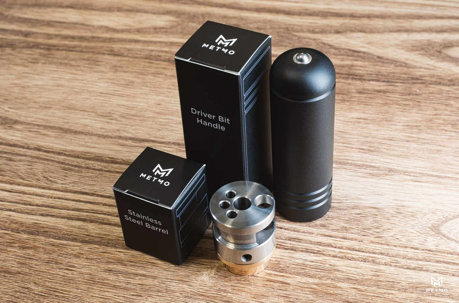

We’re not big fans of producing more waste with packaging than we have to, but with the use of our fulfilment centres we couldn’t guarantee the add-on parts would be handled correctly, so we designed these insanely cute little boxes for our upgrades.
We loosely styled them around how spark plugs used to be boxed and we now have all of these in our store room ready for when we get all of the parts. They also carry a link to some instructions on how to dismantle and change that part of the driver, so if you are giving it as a gift it wont be like a challenge from the crystal maze to rebuild your driver.

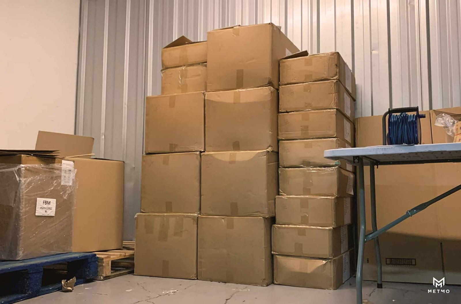

All of the MetMo Driver packaging has now arrived! We have 8500 boxes, corrugated inserts and box liners ready to go when we get all of the driver parts. It sounds minor, but these things often get forgotten about and cause delays. The team will start to assemble boxes and get them put together in preparation for packing the drivers over the next month.

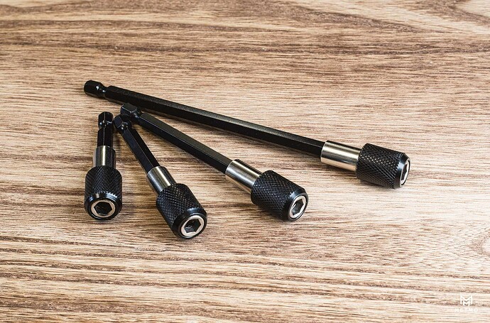

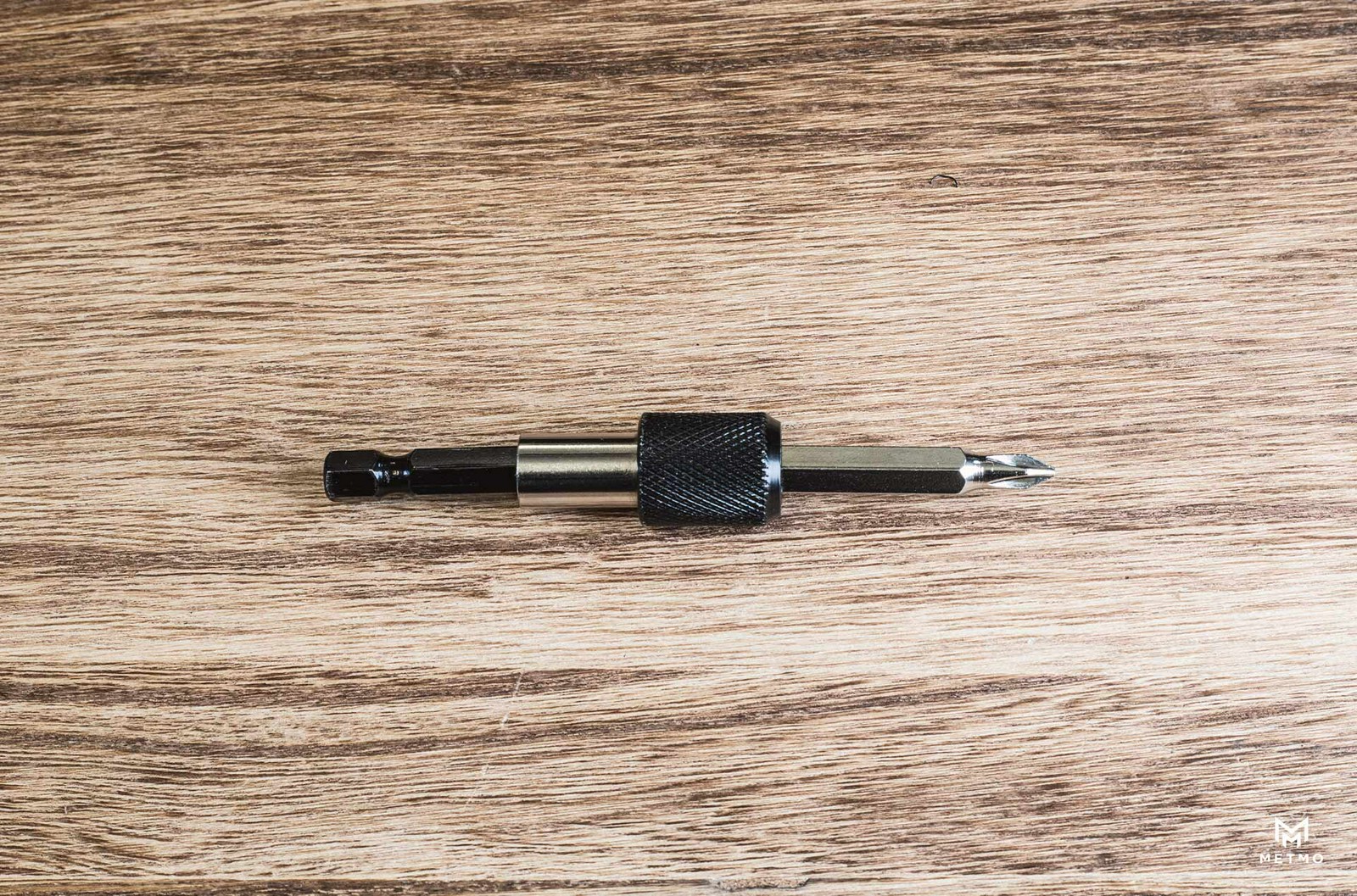

We decided that our original drive bit extenders just weren’t doing it for us. So we went and splashed out a bit and upgraded them to quick release. Because we don’t design bit extenders we had a hard time finding really good ones that we were happy with, we thought we had some good stuff but whilst doing some repair work in the kitchen with them, the magnets just fell out of one of them… in short we were not impressed.
So we went back to the drawing board and found these much nicer quick release bit holders. These combine a magnet and physical lock, with the added advantage that the bit can’t get stuck in the screw head and be lost forever down a hole! We’ve been using these and they are a much better product and they also look great when plugged into a driver too!
