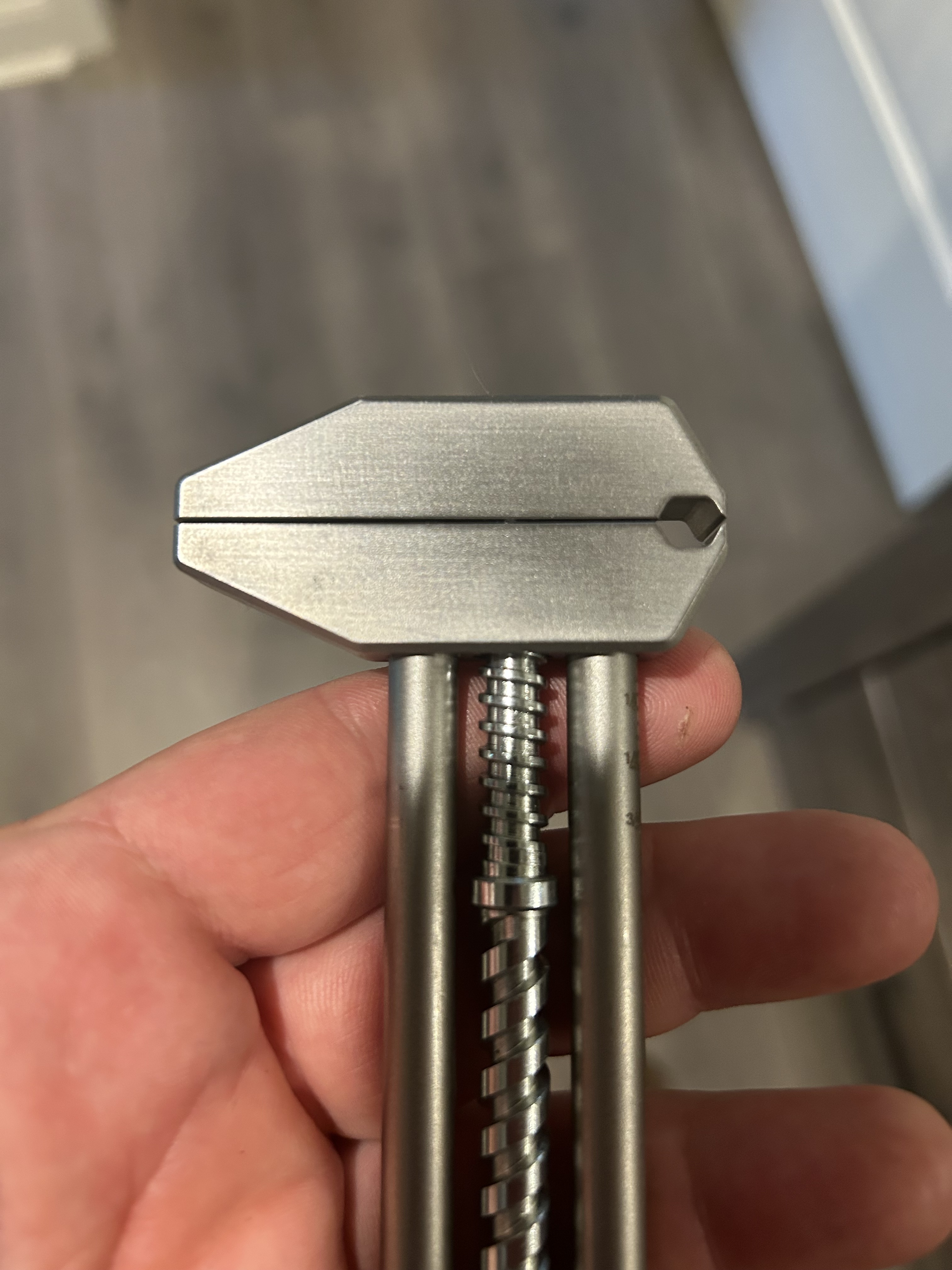

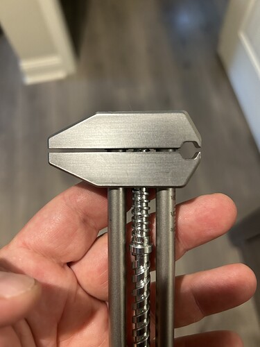

This is mine, does mine have too much slop?
